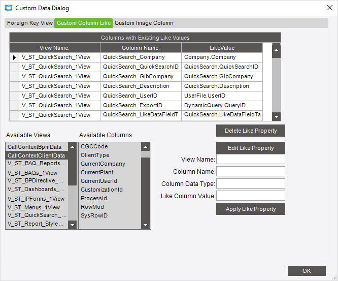

The use of CallContextBPMData and ContextClientData crops up all over the place, where is the easiest place to find the list of the available fields for these two objects?
I would go to the BPM designer, pull up a Set BPM Field widget and you should see them all listed out.
Regards
Mark
You can also see them the FKV view if you are in a Customization
