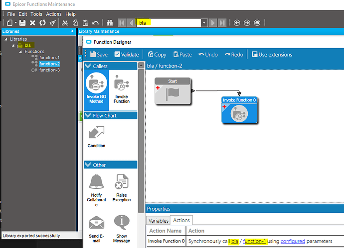

In my previous post I just used a Quick Search to self-reference my own library and it works like a charm… However it blocks you from referencing that library with other libraries (circular loop) so I celebrated too early.
I guess your easiest way is just make Function 2 repeat what Function 1 does or have a Frontend Library to your Backend Library.
