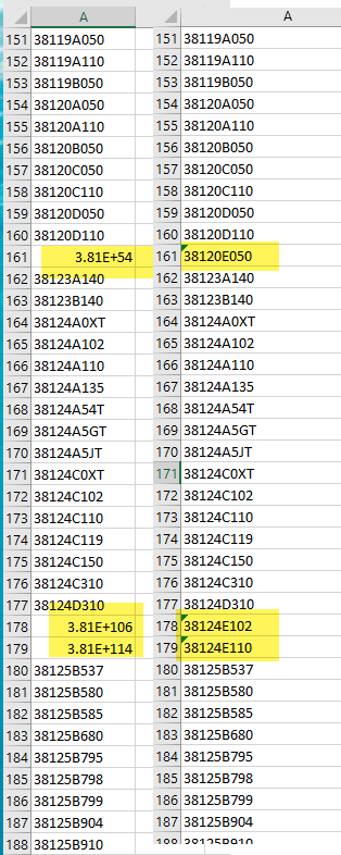

SPECIFICALLY… Excel LOVES to drop the leading zero on Northeast US Zip Codes… and if your phone numbers are just numbers with no alpha characters (like 8881234567) Excel will show them in scientific notation. There are certainly others as well.
And this one really makes work so much fun ~ our alpha then 3 number suffix material code at end of part numbers (e.g., E110) looks like scientific notation on paste…
It’s a lovely find after working the data over and getting it all ready for upload! :nauseated_face:
