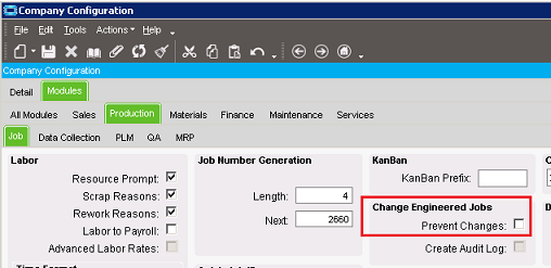

I think once a job is open and released, you can’t add or edit the operations. Right?

We unrelease and unengineer and then add ops and materials many times for mfg parts that don’t have a standard method.

I would recommend bringing in someone from finance. It’s great to fix everything for manufacturing but they don’t want to be dinged for odd efficiencies or variances.
Depending on company config?
That’s true and it’s a pretty sketchy box to clear because unreleasing and un-engineering a job is the only way out of the box to put a job on ‘hold’. So make sure you have full buy-in before checking that box!
