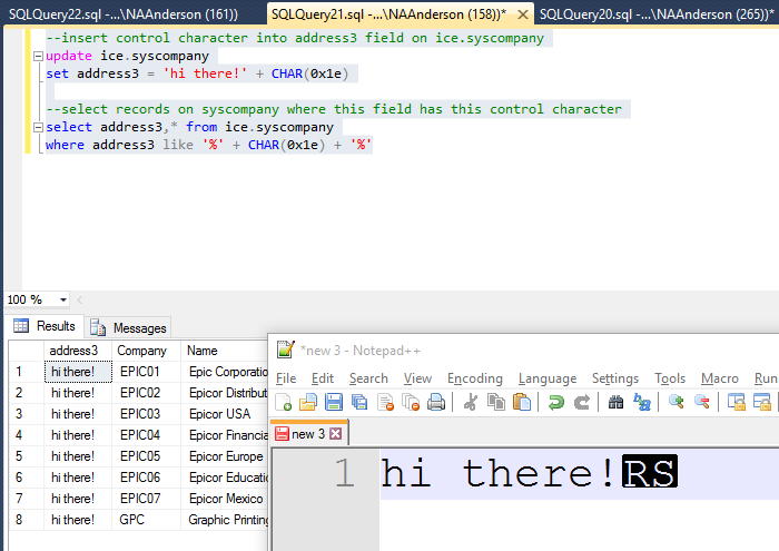

For those that feel comfortable in SSMS and have an idea of which table and field has the rogue control character you can do something like:
select [column],* from [schema].[table]
where [column] like ‘%’ + CHAR(0x1e) + ‘%’
The most common fields for these control characters tend to be partdescription and comments. If you copy the value from the column into a text editor that can show all characters (like Notepad++), you can see where the issue is.
NOTE: Make the corrections in the actual application please and thank you.

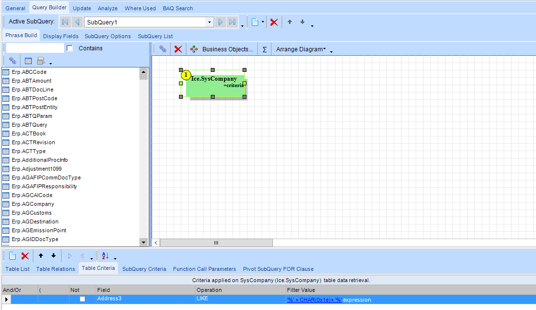

I’m assuming that won’t work with common BAQ since it’s in the system? Or should I give that a try. Unfortunately I am not able (at this point anyways) to get into the back end of the database, I just haven’t learned that skill yet. It makes sense though and maybe my IT guy and myself can get there to find it. Like you said, I believe it’s in the part table descriptions somewhere.
Thanks for the direction, I have an idea where to start now.
You absolutely can (I’m stronger in TSQL than BAQs…shh… don’t tell any of my coworkers).
Just need a table criteria.

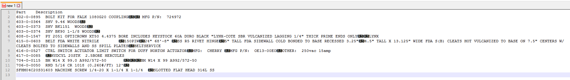

RESULTS:
Perfect!!
And there they are!!
It’s likely an ASCII Character 0x0E which maps to a SO (Shift Out) or a Control-N

So all of the parts are purchased parts which are created manually when the engineers start using them. The description is generated in Excel via a bunch of formulas that aggregate the options they are looking for and then copied in. The weird thing is, the description that is in the parts book is not the same as the description in the system, and where the funky character is located is where someone (likely the purchaser because he added something more useful to him) modified the description. Could this be something from an old version that came in? We went live a year ago and imported our parts from vantage 8.0.3, which I think was in progress (I think, I don’t really know what that means either than, not SQL :slight_smile:)
