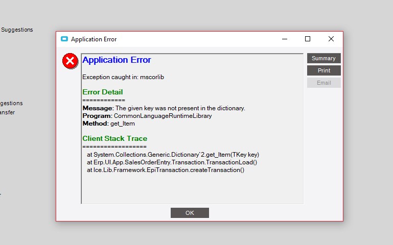

Hy, even tho I have the manager password, when I try to access the Order Entry, this keeps appearing:
Any Ideas?
Starting with the basics, are you running the base form? (open with customization, check base only check box)
Is this on everyone’s computer? Everyone’s login?
I just did this, thanks! It was just on my computer!
