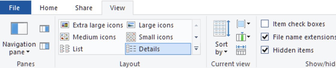

There’s one other spot where we sometimes get cache-like issues, if you go to the root of the C drive (or whatever is the main) in Windows Explorer, and check the Hidden Items option on the View tab. This will reveal the Program Data folder.
Within that folder, locate the Epicor folder. If you clear the data in that folder, that MAY solve the issue. It shouldn’t hurt anything, I’ve done it a couple of times myself.
