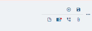

Can this part of the sales order screen be modified in Kinetic?
My users want different buttons to show up here:
Is it possible?

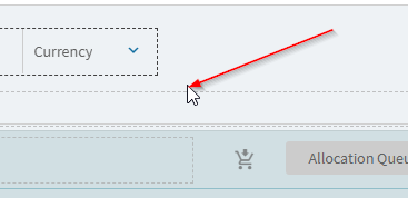

I’m on the application map in application studio and no matter which layer I go to I don’t see the buttons there so it seems like its not possible but I thought maybe there is some other way to get to that area and add different commands?
I remember seeing a way to move icons to and from the overflow menu. It is possible but I do not remember at the moment.
You have to select the form and then you can add/change/remove (I removed save):

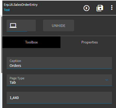

When you open application studio, click here and see the properties on the right:

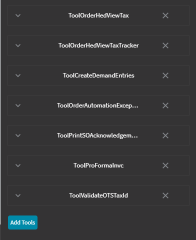

Scroll down and you’ll see all the ToolXXXXXX buttons listed. At the bottom there is a “Add Tools” button. That’s where you can add your custom buttons/icons.
