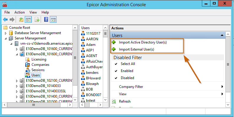

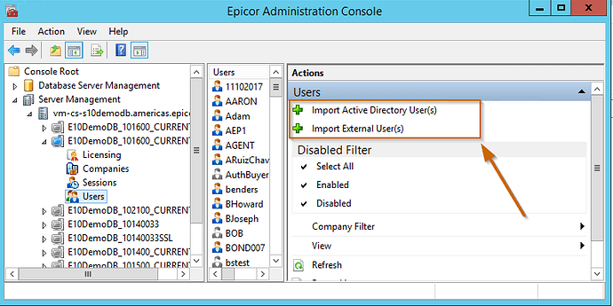

MECHANISM TWO- IMPORT ACTIVE DIRECTORY USER(S) | IMPORT EXTERNAL USERS
These two processes within the Epicor Administration Console allow someone to bulk create new users based off a “template” user that already exists within the application. During these import processes, we will create the new users so that they have access to all of the same companies, sites, and security groups that the template user selected during import have access to BUT new users do not inherit any access rights based on items that they are individually granted access to. Within the Epicor Administration Console (EAC) Help, the steps needed to use those functions are documented.

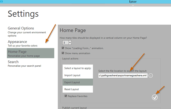

MECHANISM THREE-COPY FAVORITES(MODERN MENU) USING EXPORT LAYOUT:
  1. Log into Epicor as the user that has the favorites that you wish to copy.

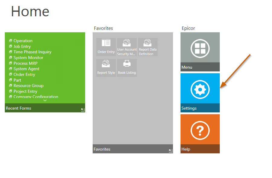

  2. Click on Settings from the Home page.
  3. Click on Home Page, and select Export Layout.
  4. Log in with the Epicor user that you wish to import the favorites, and basically do these steps in reverse select Import Layout in step 2.
  5. Any favorites to menu items that the source user has access to but the destination user doesn’t won’t be imported.

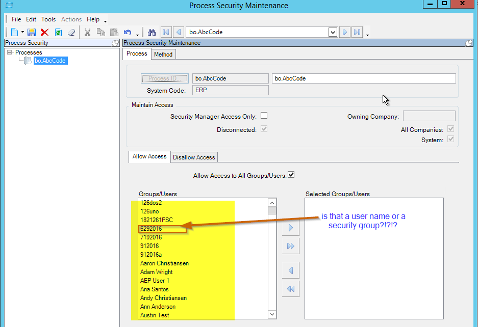

Pick a naming convention for Security Groups and Epicor User Names/IDs as there are a number of places where Security Group names and Epicor usernames appear in the same list. For example:
Some examples
-All security groups names are in all caps, and all user names are in mixed case e.g. SECURITY GROUP vs Firstname [Middle Initial] Lastname
-All security groups have a leading dash or underscore in the name(so they present at the top of the list), and user names do not e.g. Security Group _SALESMGR
-Instead of spaces in security group names you use an underscore instead. e.g. SHIPPING_&_RECEIVING
-Could append SG on the Security Group names e.g. SHIPPING_&_RECEIVING_SG
-Better yet, all of the above to eliminate all doubt! e.g. _SHIPPING_&_RECEIVING_SG
Perhaps one doesn’t need to go to that extreme :thinking:, but, the broader point is that a little planning at the beginning will save a lot of time later on.

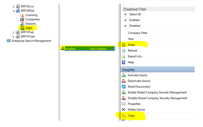

If you are referring to a basic user copy you can do that via the Administration console. Go to the application server and expand the user node. Highlight the user, and select COPY in the lower right side. After that, a PASTE will appear in the top right. Click that.
When you click PASTE the following box will appear.
Fill in the new username and full name and you are all set to go. This carries the basic configuration with it.
Ross
