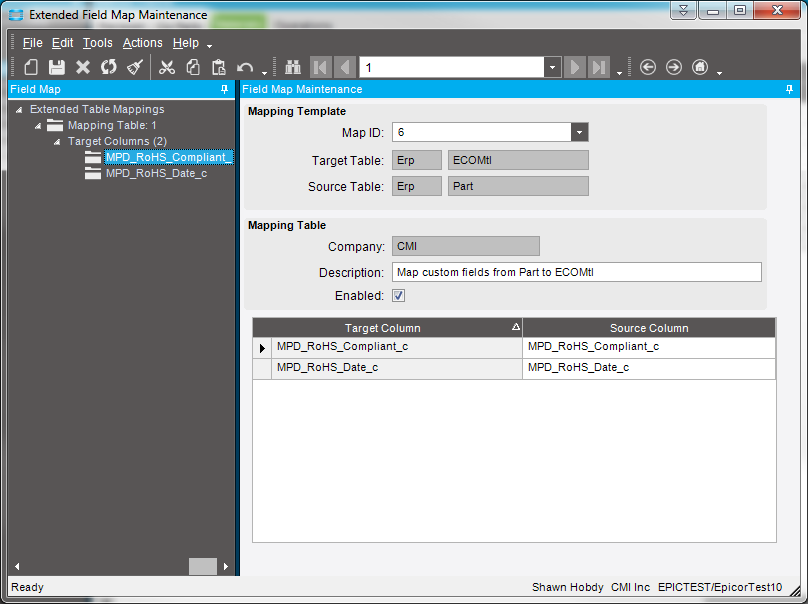

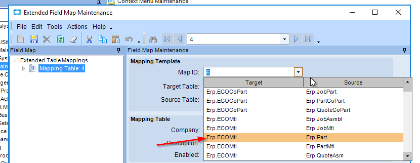

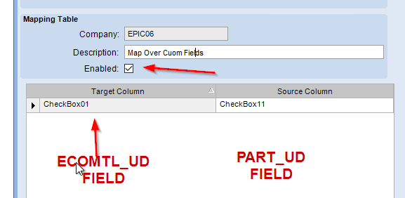

Step 3: Use Extended UD Table Field Map to map over the data from Part_UD to ECOMtl_UD
And just like that it will automatically copy those fields to ECOMtl from Part
Step 3: Can then be repeated from EcoMTl to PartMtl if you want to store them in that table. The _UD fields added to the ECOMtl table automatically show up in the Method Tracker Material List View.

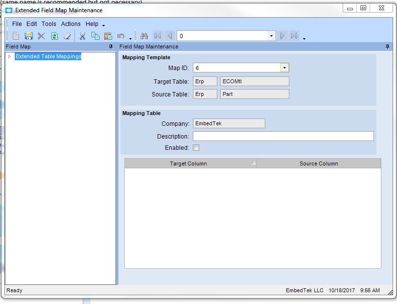

I followed your steps:
I had the Part_UD fields already created.
I created the same name fields in ECOMtl.
I did a regen and recycle app pool to enable new UD fields.
I then opened ‘Extended Field Map Maintenance’
Selected Map ID 6 (Source: Part, Target: ECOMtl)
Filled in Description and clicked the ‘Enabled’ checkbox.
Mapped the 2 fields to the corresponding tables same named columns.
Saved and exited Epicor.
Went back in and looked at the Method Tracker: Materials -> List tab and the UD fields were not listed.
I even opened Tools->Optimization and made sure the fields were not hidden in there.
