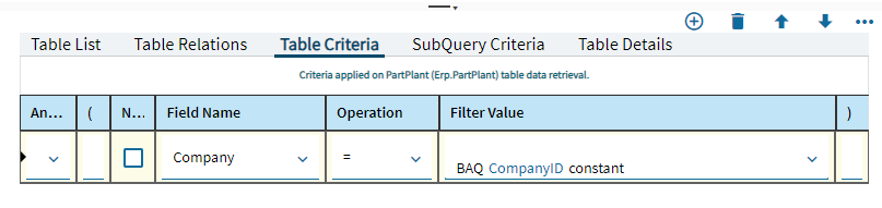

One other thought. The thing that seems to destroy the BAQ is when I try to exclude Non-Stock parts from PartPlant table. When I omit that table from anywhere in the BAQ, it runs really fast. Like 4 seconds. I add that in, timeout. Every time. Every possible way I could think of to filter out Non-Stock. Any other ideas how I might filter out Non-Stock parts beside partplant?
You could add an index for non-stock on the part plant table.
A less nuclear option would be to add the filter in the subuery results filter instead of on the table. Then it should filter after the fact. (although sometimes SQL is mean and gets helpful excel style)

This is not going to sound like an answer, but:
Add a criteria on one or more tables of this:
You would not believe how often this magically fixes BAQs.
