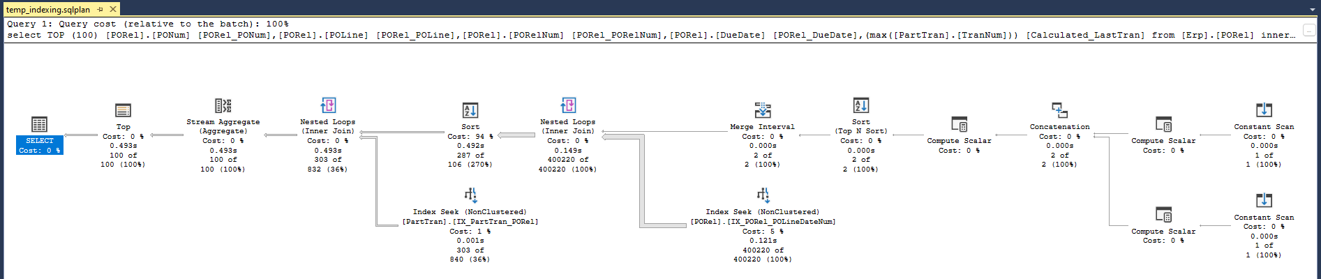

Can you force a query execution plan for BAQ
Never mind, it used to work that way.
Same indexes for me; different plan. Not surprised there.
Thank you @Mark_Wonsil and @Banderson for putting up with me. This was helpful.
OK, makes sense. That confirms what was kind of in my mind. Best practice (and necessity) tends to lead you toward good indexes. But you never know what you don’t know about, so it’s good to check the indexes, especially when you are hitting a wall with efficiency.
