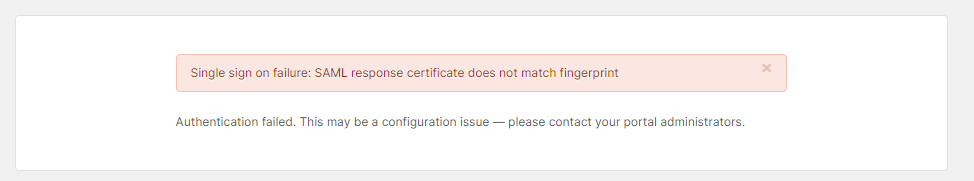

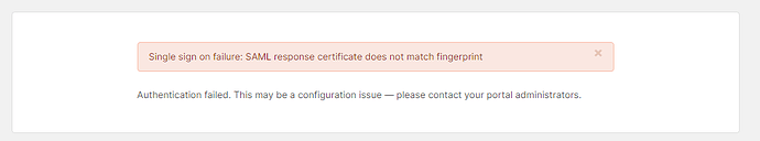

Appreciate the input that I have just caught up on. The challenge we have is that we actually need to produce a Deposit invoice for the customer so will defo vote on that idea if I can get onto the portal…
:frowning:
