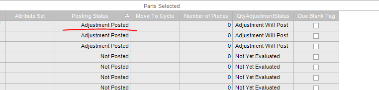

This may not be possible but I was wondering If there was any way for me to cancel a physical inventory count after several parts have already been posted?
It seems that with physical inventory I can not void any tags and I can not cancel because some parts have posted already. Wondering what options are out there, if any? Or if I would just have to enter a quantity for every tag?

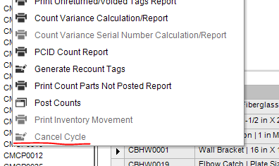

Actions -> Cancel Cycle? It’s not going to reverse any posted transactions.
Doesn’t seem possible once adjustments are posted. The action is now greyed out for me:
Seems like the only option is to get all the tags returned!
That makes sense. If it’s not going to reverse transactions, it’s just not going to let you cancel. It was a shot in the dark. I’ve never actually cancelled a count myself. All tags must be accounted for in full physicals and any missed parts in a cycle count can be rolled over to the next day.

Nope… once you have posted, there is no such thing as cancelling. Prior to posting, you can cancel (almost too easily… it does ask “Are you sure” to which it WILL if you are sure.) and all the tags go away.
