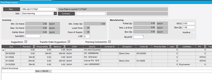

Hi all,
We have raised a PO for a part that is marked as manufactured in the system. The sales order ship by date was not aligned with the due date of the PO, which is why the system suggested to cancel the PO and created an unfirm job instead.
We have a simple question though - why did the system instead not create an expedite PO suggestion?

I thought like that too, but when you change the ship by date of the sales order for after the PO due date then the cancel PO suggestion goes away and MRP is happy. I remember @timshuwy mentioned during Epicor Insights ANZ 2024 that you can place POs for manufactured parts and MRP recognises that as a valid supply to the demand. One would expect to see a PO expedite suggestion instead of a cancellation suggestion in that case.
When you changed the ship date to after the PO was due, what day exactly did you change it to? I’m going to assume it was within two days.
That’s true, and once you had the right date it did that. But when the PO isn’t the right date, it’s not a valid supply to the demand, and so it attempts to create one. And since your system settings say that the appropriate supply type is MFG, that’s what it tries to do.

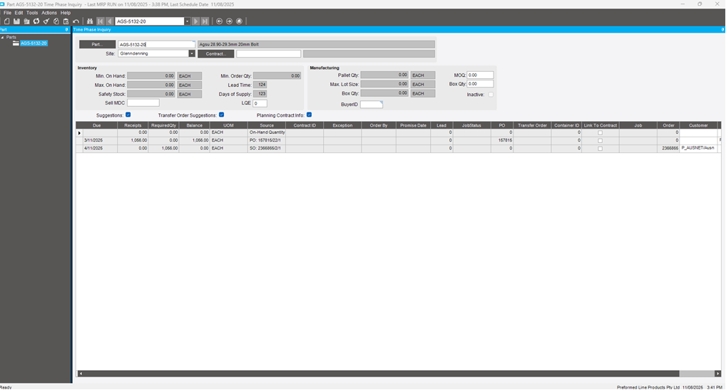

@cpilinko I changed the ship by date to one day after the PO due date
@dcamlin
The good thing about my scenario is that there is only one demand and one supply. If you look at the screenshot, MRP has the ability to recognise that the PO has been placed to satisfy a sales order line that is usually manufactured. No cancellation suggestion, which should have been the case as per your scenario right? Maybe if we had a buy direct link in the previous screenshot then it would have shown an expedite suggestion instead of cancel? We try to avoid buy to order unless we are doing dropshipments because we are unable to track the stock in our warehouse using bin locations, which is a different can of worms that shouldn’t be opened in this thread hahahaha

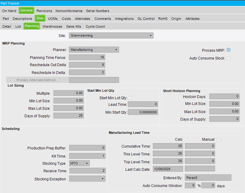

Doesn’t the Reschedule In Delta stop MRP from making suggestions to expedite current supply?
  • Try setting Reschedule In Delta = 0, what happens?
  • If setting the Reschedule in Delta = 0 results in an expedite suggestion, then turn it back to 5 and set days of supply = 0, what happens?
  • After those two tests, lock the PO qty, then repeat them, what happens?
If my theory about the reschedule in delta is correct then it’s acting kind of like a locked PO date. In my testing (locked PO dates + days of supply) = erroneous and infinite suggestions.

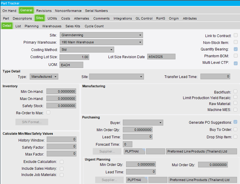

As someone mentioned above, we have a NEW FEATURE in Kinetic 2025.1 where you have new options in the Urgent Planning parameters.
If an item is deemed Urgent (based on the lead time), you can now trigger the urgent option to be switched to either Manufactured, or Purchased.
Example, if the item is normally purchased with a lead time of 10 days, but the requirement is 5 days out, then you can mark it to be Manufactured. The opposite is true also… if it is normally manufactured but urgent, you can have it Purchased. Here are the various scenarios:
