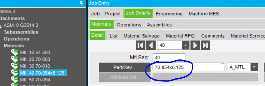

I need to change .125 to .625. The issue was as you said previously, so I did the change on the job entry, did the return, but now when I tried to change it again, it here where I’m not able to do it.
try refreshing first, then make the change.
Same thing. It doesn’t work. I did the refresh, re-wrote the correct part number and then I tab, the system changes back to 6.125 I need to put 13.625

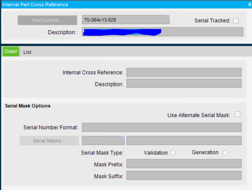

Do you have a cross reference in your system for it? Check internal part cross reference.
Not sure how I can check that in the system. but I don’t think the material has a cross reference. Otherwise it should have able to change it earlier…
There’s a screen for it,
But if you can’t find that, for grins and giggles, make an order and try to put in that part number on a line. (you can just delete the order when you’re done). See if it does the same thing.

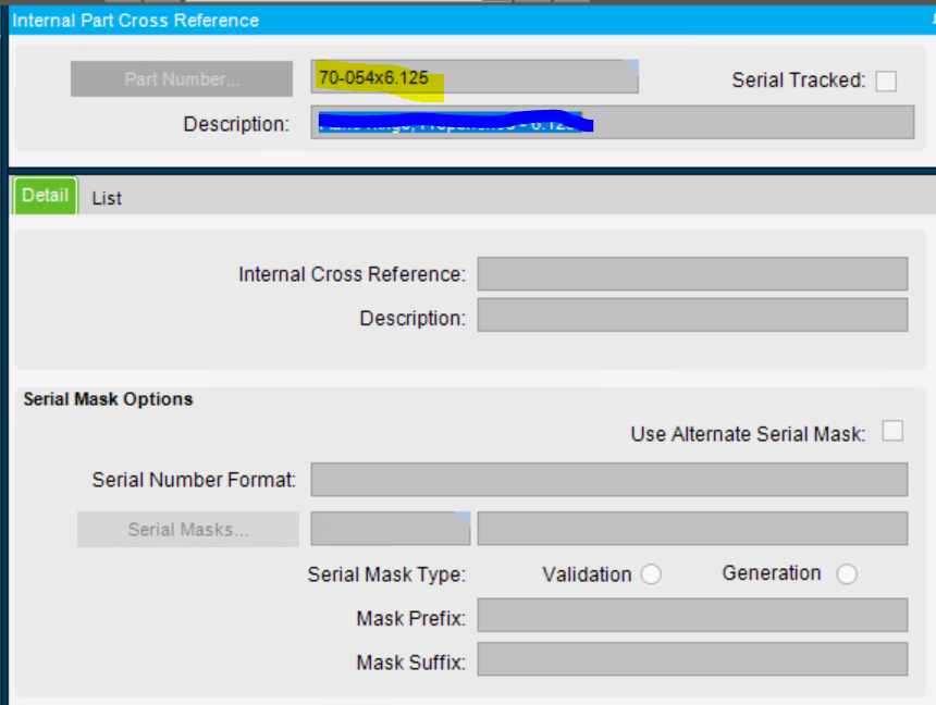

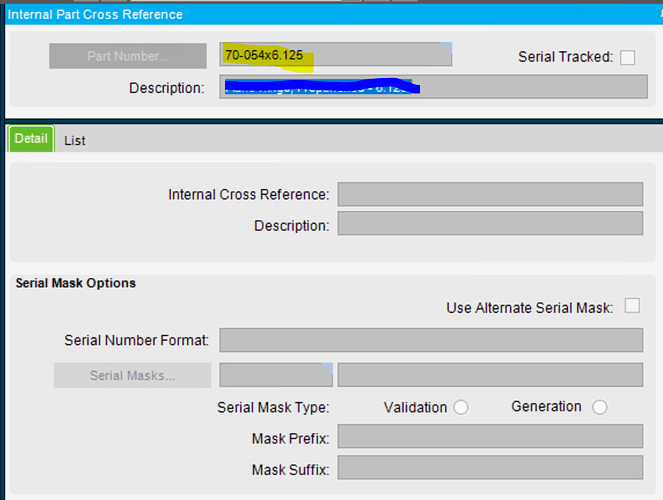

None of them have cross reference:
Here is the other part:

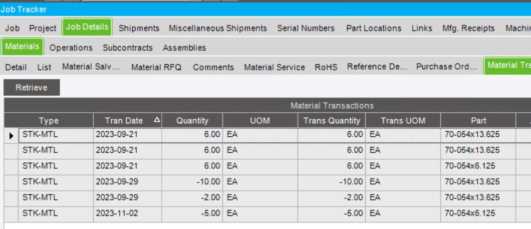

Quick question. I verified the job tracker, and I found the return it was 5 instead of 6, that might caused the issue of not allowing me to change the part on job entry?
Should I return 1 more to clean the 125 and reinstate the 625 as per instructions?
See the last line, where it says 5 pieces.
You can always change the part on the job entry. It doesn’t care what was issued.
