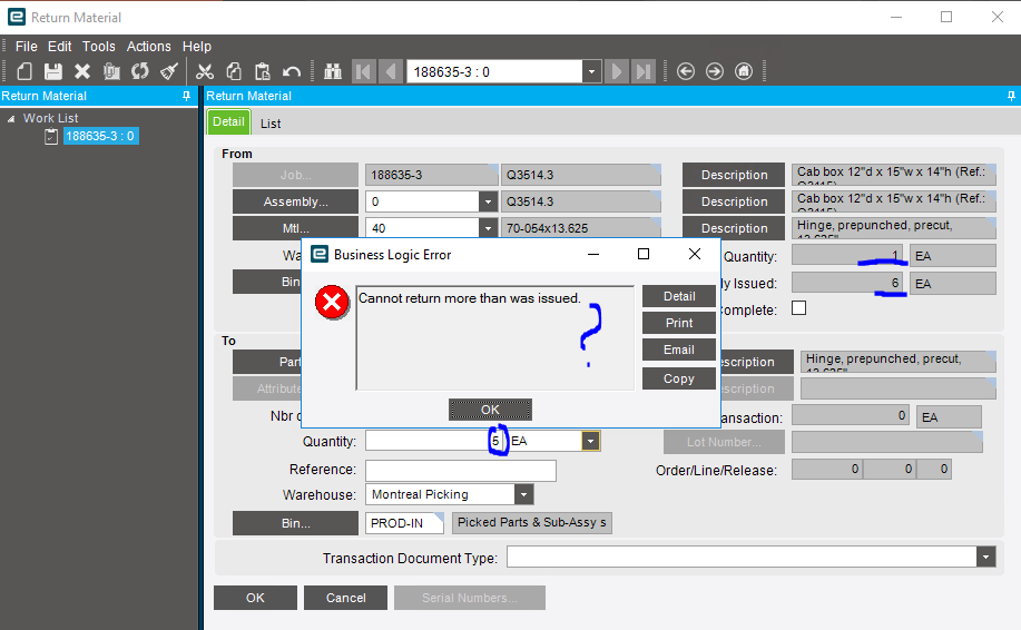

Cannot return more than was issued
Hi colleagues. I got this issue when I tried to return material. I tried with 1, 2, and any number; when I tab, it comes up this error message. Do you happen to know why?

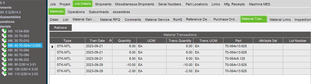

In Job Tracker, for that material, what does Material Transactions show? If it shows less than 4 issued, that would be the reason.
I’ve seen this happen when just the job requirement is issued to the job but the issuer physically grabs more “just in case” and then tries to return them later.
Amazing Jeff. I believe you got into the right root of this issue. Can you please help me to understand this table? I’m new on Epicor. Thank you for your tremendous help.
I see that one part was changed. The team player took 12 from …625 and 6 from …125. Then he returned 12 from 625, but left 6 of …125 (part). Is this the root cause?
Yeah. It has to match the transaction that it came in on. You can change the part on the job, do the return, then change it back.

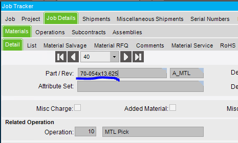

Yes, I can’t change the part from the job, it’s not an editable field to change.
Can you please remind me the steps to make this happen? Appreciate your help with this.
right here?

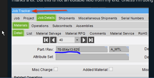

Thanks a lot. But this is not an editable field from my end. Unless I’m doing something wrong.

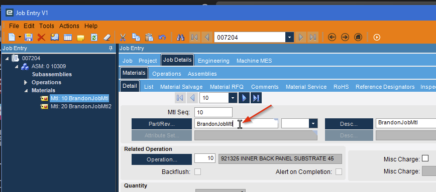

You’re in the job tracker. You need to be in job entry.
Excellent. Thanks a lot Brandon. Sorry about that, I’m fairly new with Epicor. Learning from experts like you. Thank you once again.
