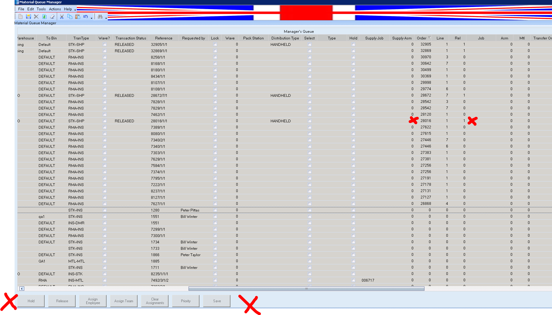

This looks ok to me?
The sales order/line/release is in “Material Queue Manager” but not “Material Request Queue”…and all of the options are not selectable at the bottom.

After doing the following i was able to close the two sales orders.
  1. Went to the “user security” and loaded manager (who i was signed in as)…went to the company tab and ensured that an employee was assigned in the employee field…i selected myself (Mark R)
  2. Went to employee maintenance and loaded Mark R…and ensured the following tick boxes were ticked. “material handler”, “shop supervisor” “shipping / receiving” “production worker” “can override allocations”.
  3. Now when i went to Material queue manager (in advanced material management)…the options at the bottom were highlighted to select…I found the sales order in question, assigned Mark R and clicked save and closed.
  4. This then put the entries into “My selection” tab on the Material Request Queue (in advanced material management) and i was able to select and click delete.
