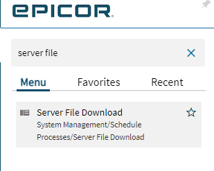

Went to server file download app:
Selected the files to download.

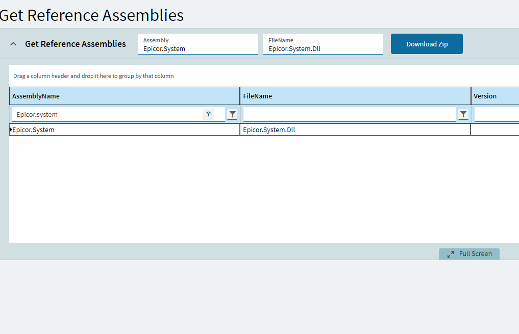

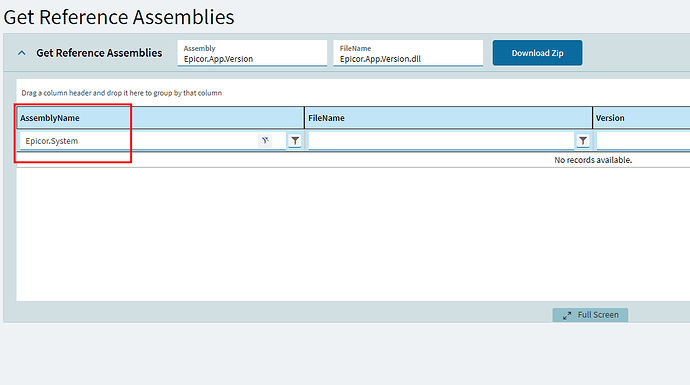

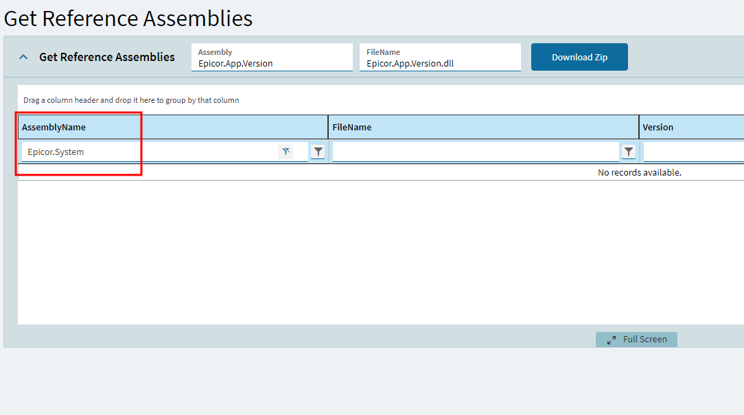

Hello @klincecum do you know by chance what happened to Epicor.System
I needed to clean format my machine and lost some files. It was available a couple weeks ago. We’re on version 2023.1
klincecum
(Kevin Lincecum)
July 7, 2023, 1:18am
14
I believe you have the name wrong of what you are looking for.
klincecum
(Kevin Lincecum)
July 7, 2023, 1:32am
15
Nevermind, not sure why it doesn’t list it, but it’s available. I’ll fix it.

shuotonashi
(Victor Hugo Garcia Rocha)
July 7, 2023, 1:45am
17
It working now! I wonder if that was caused by the update.
Thank you!
