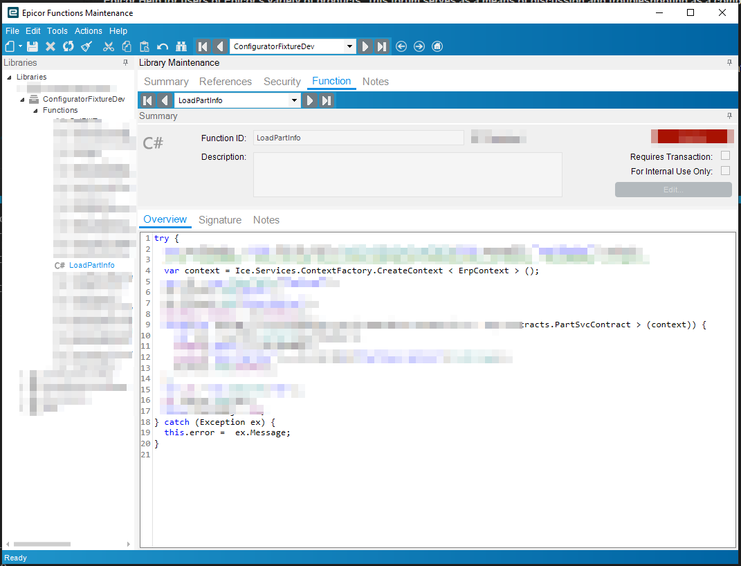

Use Visual Studio or VS Code as an editor instead of Epicor Functions Maintenance
Is it possible to use another editor instead of the one provided to write Epicor functions? It would be nice to have code completion and version control to speed things up and be organized. If I knew how to find the assemblies the stock editor was using I could at least copy the code back when I was ready to run the functions. I found the Epicor Customization Editor for Visual Studio by @josecgomez it looks cool but from what I can tell it is something different from what I am describing. Any ideas?
