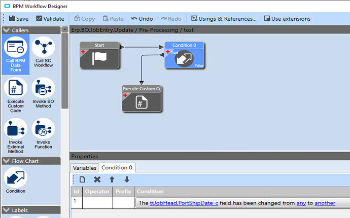

Hey,
I know this used to work, I think.
I want to get the original value of a field in job entry update. So I do something like:
That part works. But when I use this code I can’t see the row where RowMod = “”
Note that the “where” line is commented so I should get every row.
foreach(var ttJobHead_xRow in (from row in ttJobHead
//where row.RowMod == String.Empty
select row))
this.PublishInfoMessage("RowMod " + ttJobHead_xRow.RowMod, Ice.Common.BusinessObjectMessageType.Information, Ice.Bpm.InfoMessageDisplayMode.Individual, "", "");
All I’m getting is RowMod = “U”
If I add in the where statement to retrieve only the unchanged row I don’t get anything.
It does this in 10.2.300 and the 10.2.700 upgrade-in-process instance.
Losing my mind?
Thanks,
Joe
