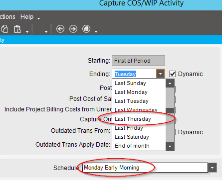

@timshuwy how would the setup look in the Capture COS/WIP Activity form? I don’t see how you can dynamically get the ending date to be 3 days ago, if that is even how you would set this up? Thanks.
I have always wished that this “Dynamic” dating had a little more flexability… I wish you could just the COUNT of PERIOD types… ie -5 days, +2 Weeks, +9 Months, etc… but for some reason, development still has this fixed list…
BUT All is not lost. In this case, you CAN achieve the goal by scheduling the process to run on 5 separate schedules… run it every weekday Morning, with separate parameters for each launch. Example shown in the screenshot, you would create a schedule called “Monday Early Morning”, and then choose the ending date for the Monday run to be “Last Thursday”. Following this logic, you would have:
  • Sched–Ending Date
  • Mon–Last Thursday
  • Tues–Last Friday
  • Wed–Last Monday
  • Thr–Last Tuesday
  • Fri–Last Wednesday
