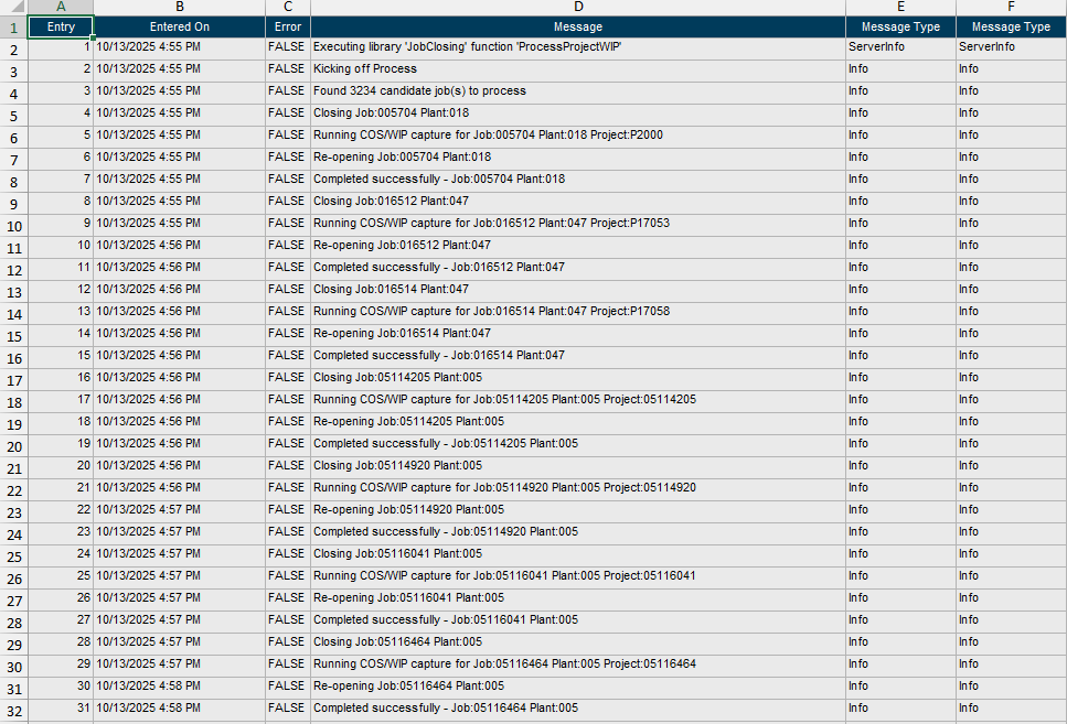

So here’s the finished product (even added task logging so we can see if it gets stuck)
Much nicer! Running it now in sandbox to see if it doesn’t crap out. Thanks Everyon!
super slick, nice work!
So interestingly it ran 900+ projects and then it threw the same exact error we saw in production before.
Underliying provider failed to open
Somehow the act of opening / closing and posting jobs is causing something in the Db to just throw its hands up. So frustrating, if I run it again it works again… until it doesn’t
