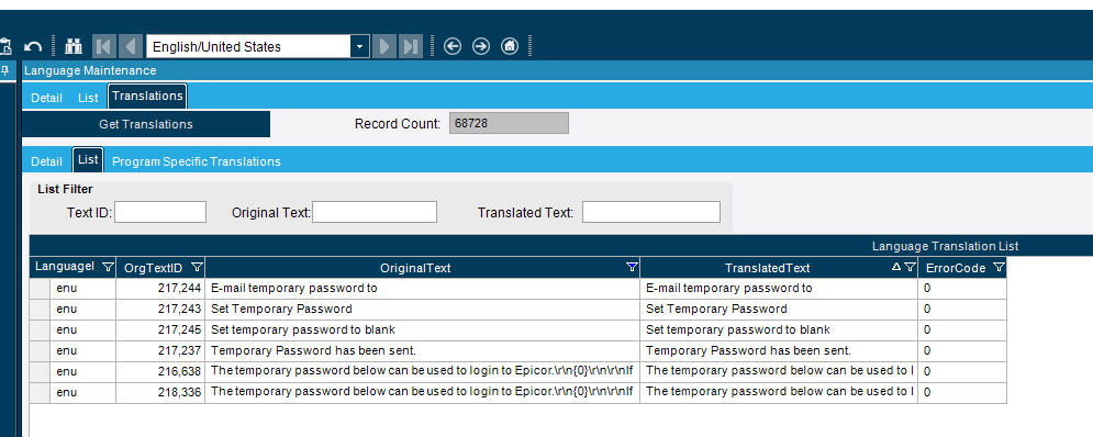

I wonder it Rich’s fix for changing a default message would work?
Tried that, change the 218336 text that corresponded to the email message, but it did not change in the email. as it looks like it is hard coded into the DLL…
