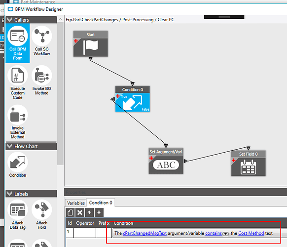

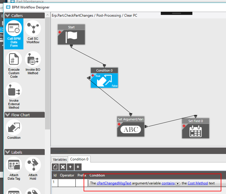

Adam,

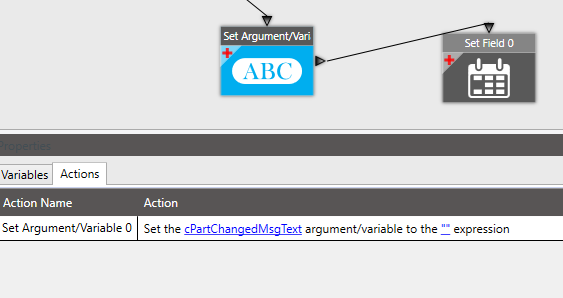

The CheckPartChanges Method has 2 output variables the variable named cPartChangedMsgText is the one that Triggers the PopUp. If you were to put a Post Processing BPM on CheckPartChanges and set the value of cPartChangedMsgText="" then the popup won’t happen… However that means you have to account for what clicking YES does. This means you’ll have to set the UpdatePartPlant flag = true in the same BPM.

What I can’t figure out is what action to use. I think your third screen shot was going to show me, but it looks like a duplicate of your second screen shot.

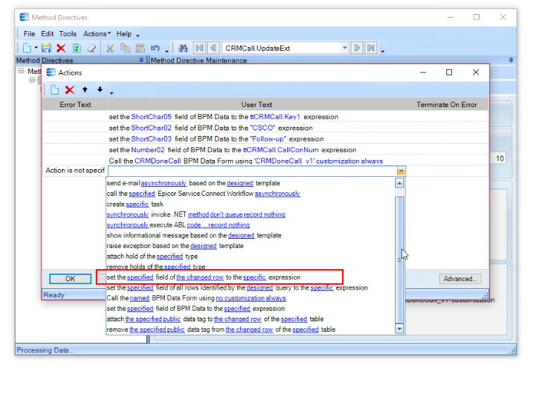

Is the SetField action…

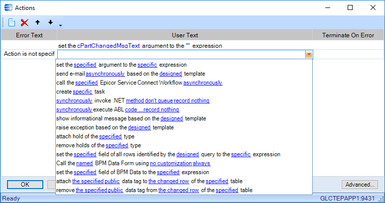

I only see two with set, but neither of these work. (I am using Epicor 9)
“set the specified field of all rows identified by the designed query to the specific expression”
“set the specified field of the BPM Data to the specified express”
Thank you @jgiese.wci for the screenshot
Thank you. I don’t have that option on the post-processing dropdown. I tried adding the following to pre-processing, but the update didn’t work:

Yes, my user is set to advanced BPM. Below is the dropdown options when trying to add this Post-Processing action:
Try the one that says Set the specified field in all rows identified by the designed query to the specific expression… and just pick the Field that you want in that BAQ.
