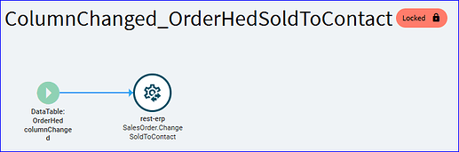

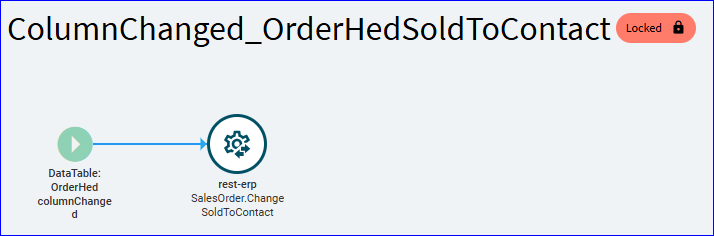

User picks a Sold-To Contact from the dropdown list. The “value” of this selection is the OrderHed.PrcConNum.
An event fires (ColumnChanged_OrderHedSoldToContact)…
This performs a rest call using the Erp.BO.SalesOrderSvc - ChangeSoldToContact which sends:
The updated value of PrcConNum (Field “A”) and pulls back new values for various display fields like SoldToContactPhoneNum (Field “B”) and SoldToContactFaxNum (Field “C”).
In this example case, I think the rest call service is sending the entire dataset back and forth in the Request/Response.
Anyway… if you can find an example of what you want… you can follow the event sequence in debugger (like I did above) and then try to replicate it in your own events in your use-case. Or… if you can give us more details on what you need, we can try to help in more detail. But it may depend on the SOURCES of values for A & B. Where are the values of “B” being sourced and stored? A BAQ and BAQ Dataview? An Epicor table which can be set via rest call (like the above example)?
