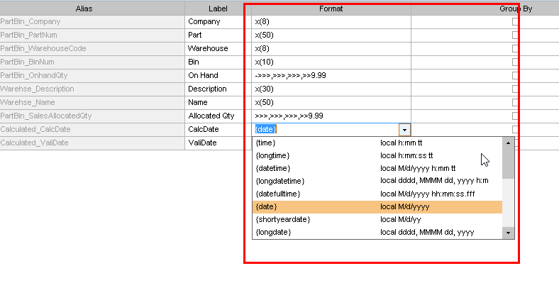

You can specify the output format in the BAQ
Fields that are stored as Date can retain thier date value but be displayed in other formats supported by Date types.
And you can dictate if the integer should use commas (->>>,>>>,>>9) or not (->>>>>>>>9)

I tried messing around with the BAQ formats, it even updates on the bound EpiNumericEditor, but the format doesn’t always seem to change. I believe it’s driven by some simple link that doesn’t have the options that you do if it’s unbound.
For example, I don’t think you can conditionally have decimal places. It’s either there or it isn’t. I tried with >>>,>>9.>>, which works in the BAQ, but in the field it still shows 0.00. If I do >>>,>>9 then in the field it shows 0. Then if I do >>>,>>9.99 then it does 0.00 again.
At least I have some control…
