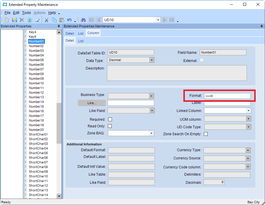

Have you tried setting the Format in Extended Properties?
Yes I have but I did not regenerate data model afterwards. Trying that now.

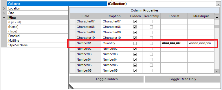

Set the Format and MaskInput in the Customization
Regenerating the data model did not work.
Setting the Format and MaskInput in the Customization will not work because the fields are populated by a BAQ at run time.
