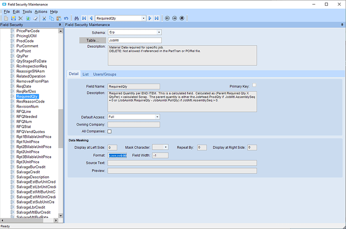

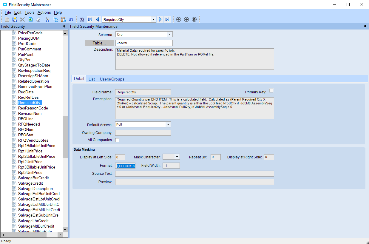

Well that doesn’t work… It seems to stem from the problem of JobMtl RequiredQty field only being formatted for 2 decimal places… Ugh…
Please hold, I may have been editing the wrong report…
Yup, that was it… I edited the correct “custom report” file and it now shows 4 places. whoops!
