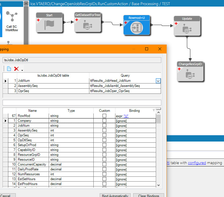

First, I pull the DatasetForTree.
Next, I set rowmod=U for the JobOpDtl table based on the ttResults query, mapped as shown.
Then, I update tsJobs.
Then, I ChangeResourceGrpId for tsJobs.

You don’t need the Update one.
I am guessing you aren’t updating the correct JobOpDtl, based on this.

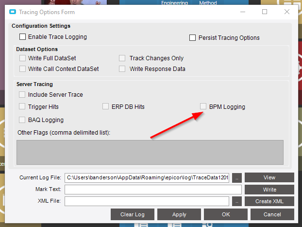

I think the tracing from the BPM needs to be looked at server side.

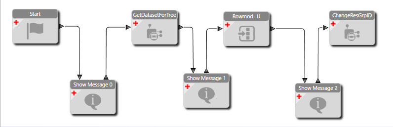

Just out of curiosity, pop in some message boxes that show your row mod. Do a message box in between each step. Sometimes those change methods will fork with the row mod.
Between start and GetDataset:
"JobOpDtl.RowMod = "
Between GetDataset and Rowmod=U:
“JobOpDtl.RowMod = ;;;;;”
Between Rowmod=U and ChangeResGrpID:
“JobOpDtl.RowMod = ;;U;;;”
Adding the server BMP logging didn’t give me anything useful in my trace.
That doesn’t show up client side. Forget it for now.

add one more box at then end. And show some other stuff to make sure the row is being populated.
check the box for JobNum, AsmSeq, OpSeq etc. Make sure there is something in the row.
I see that my messages are returning all the operations for the selected Job from the JobOpDtl table. Hence the ;;;;;;;

I changed my set field by query widget to update only the changed rows, instead of all the rows.
Now I am back to getting the error: Operation Detail is not available.
Since I had better results with “all” rows on, I changed this back. It look slike in my last message the rresource grou ID is changed in tsJobs.JobOpDtl. Clearly this tableset isn’t being pushed out to the database.
So I added the update back at the end, and now I get those same two errors:

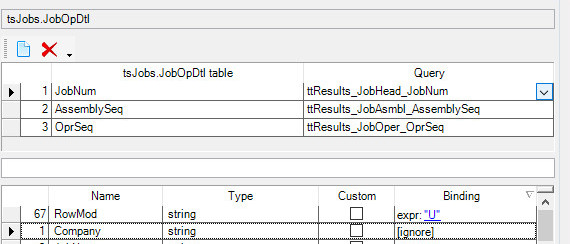

what does your set record query look like?
For the Set Field By Query Widget I have the following properties:
MyQuery = ttResults (all fields)
update all rows of
tsJobs.JobOpDtl
with mapping as show:
