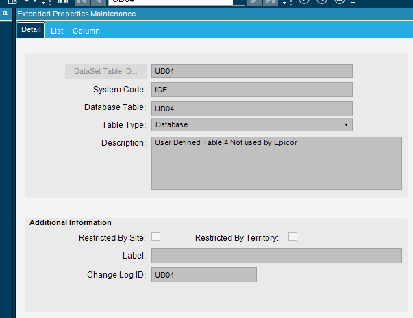

Is there a way to change the table descriptions of the UD tables so it shows up here? Since I am using these tables, it would be nice not to have to cross reference every time I need to use it in a query.
Look in Extended Properties Maintenance (not sure if its updateable)
If ti isn’t you could do the change in the ZDataTable … but that would require an udpatable BAQ or direct SQL… (Not recommended)
It is not. That isn’t where it’s pulling from anyways since that isn’t what it says. I guess I don’t even know where that comes from.

TableDesc in Ice.TableAttribute might do it. You certainly use Ice.ColumnAttribute when needing columns desc’s etc in Data Dictionary and BAQ,
I’m assuming that would be with and Updatable BAQ? Or is there a menu to change these?
I made a UBAQ and am able to change it. Thanks!
Great! As I said, if you want to extend this to columns then you should look at Ice. Column attribute.

I’d request that development expand the Extended Properties screen to allow changing UDx table description properties. Seems like the least painful place for us to incorporate that ability as most of the bits are already there.
I would agree, That was also the place that most people expect them to be as shown by my initial search, and Jose’s initial suggestion as well.
