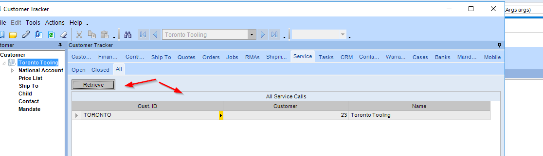

Changed a grid in Customer Tracker, how do I get the Retrieve button working?
Hello,
I followed the instructions that Jose posted in another area https://epiusers.help/t/efficiently-adding-column-to-datagrid/36283/5.
I created a replacement for the Customer Tracker ‘Service->All’ tab.
It works fine except for 2 things, neither a deal breaker:
  1. The Retrieve button doesn’t work
  2. It auto populates instead of waiting for the retrieve button.
I know the old button is linked to the old grid view. I just haven’t done anything with buttons before so was looking for some guidance on how to set up a new button.
Also, once the button works, how to I turn off the auto populate of the grid?
My alternative if no one can help is to just delete the existing button and let it auto-populate but I would like it to match the other tabs next to it in functionality.

You could change your subscsribe to subscribe from the “old” dataview that theg rid was attached to and that should cause the BAQVIew to not treive until it has been populated.
I am not sure what you are saying.
The old databinding was called ‘ServAll’

What would I change?
Change this to come out of the “old” EpiDataView that was bound to the grid
“MyOldIVew.CustID”
I’m sorry if I sound dense, but how would I find out what the old view binding was?
If you open the “BASE” customization and click on the grid you should be able to see what it was bound to: ServAll
Looking through the columns in that ServAll dataview, I see there is indeed a CustID column
So changing your
To
string pubBinding = "ServAll.CustID";
Might do the trick, let me know if that works (I haven’t tested it)
That was the first thing I tried when you suggested it. I was hoping I was mistaken.
It didn’t work for me.
It doesn’t populate the grid anymore, clicking the retrieve button doesn’t bring it back.
Maybe that is my issue. Should the original Retrieve button work after this change or will I need to somehow create a new one?
So CustID is blank in that grid… cause #Epicor… change your query to use CustNum and try again
Yup that works

A little guidance on “it’s not working” would be helpful
What is not working? You posted a bunch of code but I can’t just go through all that without some sense of what the issues are.
What are you trying to do (end goal?)
How are you trying to do it?
What’s the error or issue you are encountering?
My apologies,
The request was made to add an additional (custom) field to different tabs on the Customer Tracker and not have them refresh the data until the retrieve button was clicked.
For each tab, I built a separate BAQ and created a view for each of the requested tabs with the initial EpiBinding pointing to the original binding to allow the grid to be created upon initialization without pulling data on the pubBinding change until the “Retrieve” button was clicked.
After finding this solution under " Changed a grid in Customer Tracker, how do I get the Retrieve button working" I modified each of the CreateBAQView segments by setting the string pubBinding to the original epiBinding and changing the IPublish to var as described in your answer to shobdy.
After doing so, the tabs under Customer - Orders (Open, Closed, All and By Ship To) worked beautifully and returned data after clicking the “Retrieve” tab as described.
The Tabs under RMA’s and Shipments, however, are returning no data on the “Retrieve” button click.
I know it’s a lot to unpack as there a multiple tabs and multiple queries but I was thinking that the same process would work on each of them.
Any assistance that you can provide would be greatly appreciated.
Johnny
