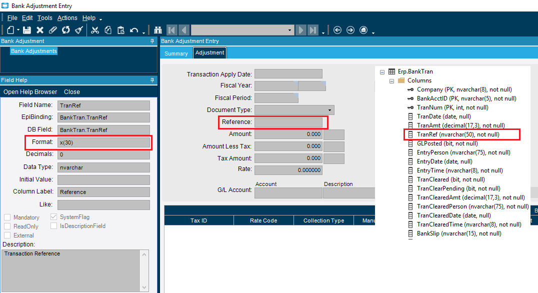

There is Reference field on the Bank Adjustment Entry screen. Only 30 characters are allowed to be entered there.
However, the field size of TranRef in the database is actually nvarchar(50):
We would like to increase the Reference field size on the Bank Adjustment Entry screen to allow up to 50 characters. Is there a way to increase the size of that field on the screen other than customization or using UD?

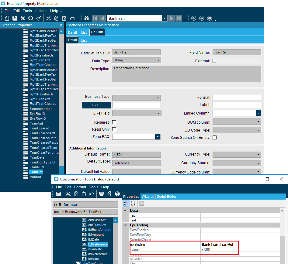

Extended Property Maintenance you can change the format thre x(50)
Hi @josecgomez
Thank you for your reply.
I checked the Extended Property Maintenance and it shows x(50). However the textbox properties still shows x(30) on the Format.
Is there any table that stores/controls the textbox size?
Thank you.
No, try changing the extended property on the Form itself.
You would need to change the field in the form as a customization most likely.
Set the format here to your field.

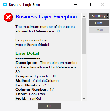

Hello,
the change worked on my testing environment but when I did the same thing to live, it gave me this:
Is there a location where I can check the Validation rule?
Hello josecgomez,
We did the setting as you suggested. We have updated extended property format to x(50) then restarted epicor, recycle epicor app pool, regenerated data model but still we are getting same message as mention below. Please suggest if anything we are missing in our steps.
Thanks in advance…
Recycle after you regenerate.
done the same, but still not working

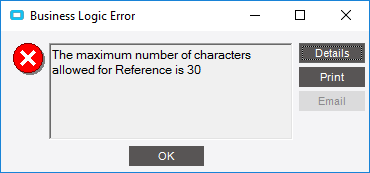

Hello,
I am having the same error as this, do you still remember how you fixed this one? Thanks.
Is there a definitive answer about whether we can change the field length of native fields? I’d love to do the same with the Reference field on OrderDtl (only x(10)). The marked Solution in this thread doesn’t actually seem to have worked.
