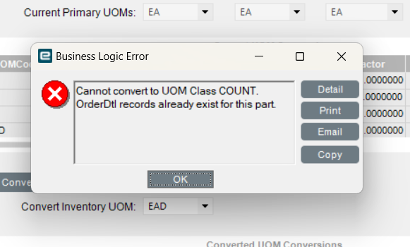

So I hit a snag.
I’m unable to convert it because there are sales orders that exist for this part.
The sales orders are closed and there is no demand for it but because there is a sales order out there with the part on it, I’m unable to use the conversion tool on it.
That was just testing on a few parts. I’m unsure epicor will even let me switch the UOM with parts on old jobs as well. Assuming this will have the same issue as sales orders.
Starting to think I will have to create completely new part numbers for this at this point. Probably the better move. Then 0 out the inventory on the old parts and add the inventory to the new parts.
