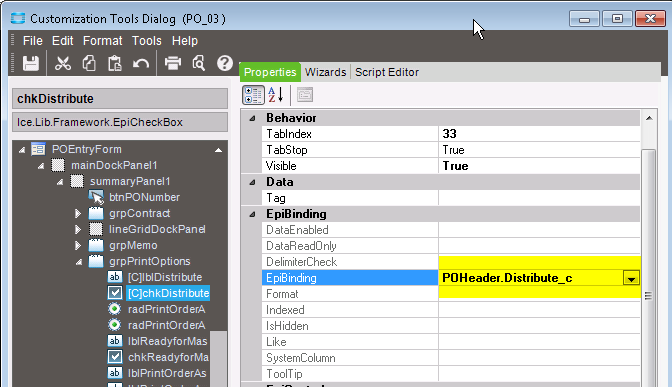

You don’t need any BPM or Data Directive. Just bind / set the source of custom control to the Checkbox01 field.
Here’s a screen shot of the Customization window for a customization we did on the PO Entry form.
We’re on E10, so we don’t have user fields like Checkbox01, but rather added a custom field “Distribute_c” to the POHeader table.
In your case you want something like this (but whatever E9 looks like) and the field you bind to should be PORel.Checkbox01
