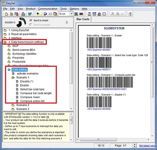

Yes the CK75 Handhelds atleast w/ Intermec have a software called “EasySet” which lets you programming skipping prefixes, post-fixes, etc… on your computer it then generates a barcode, you scan it and the Handheld programs itself.
It’s very common to use EasySet for things such as AIAG Labels where you have to eat away prefixed barcodes with P10292, KPONumber, etc.

I might even have my PDF where I programmed CK70 for AIAG but only for Code128 so I could still use Code39 internally with those embeds if necessary

Here is what I used - For Reference
