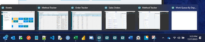

Hello, we have some dashboards that we run in classic because of issues with speed and parameters in kinetic dashboards (I’m aware the parameters have been fixed in the latest releases, we just haven’t had a reason to upgrade the dashboards). Lately, we’ve had the classic versions just freezing for some users. I’ve tried giving guidance with no luck and as of today I’m experiencing it myself when I try to open any classic dashboard.
When hovering over the Epicor icon in the taskbar you’re able to see the opened dashboard, but it is a blank white screen. When you try to click on it, it will not pull the window up. On Dashboards with parameters, the parameter window pops up and allows you to enter your parameters, but once entered the main dashboard screen is still stuck in the task bar.

Yes. It’s because the window is off screen. Here are the steps to fix:
Hover like you did
Right Mouse Click
Choose Move
Click an arrow key, any one will do
Now use your mouse to move the screen back into view.
The reason this happens is a person who saved the position (a developer, or yourself when docking and undocking) to a screen that doesn’t exist for the current user.
If you want to correct this permanently, open the customization, go into the XML view (from the menu), and find the .Top and .Left properties on the form itself. Delete those two properties. The window will reset to default position.
