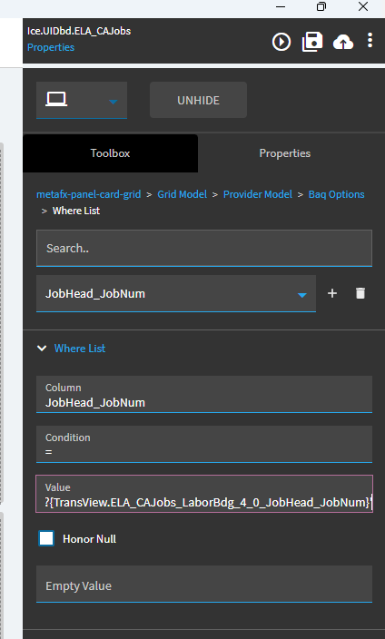

Here is an example of the Where list for one grid.
Are you suggesting to take out the TransView?
Yes, I am.
Change it to ?{ELA_CAJobs_LaborBdg_4_0.JobHead_JobNum} assuming your publishing grid is bound to the ELA_CAJobs_LaborBdg_4_0 dataview.

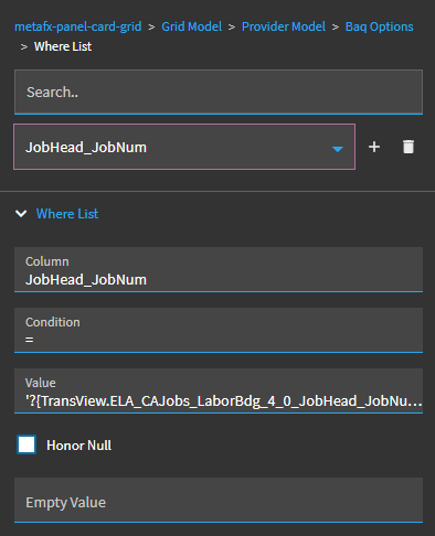

The is what it has without any modification:
The Provider Model has a Baq ID ELA_CAJobs_LaborBdg
BAQ Option - Where List is as shown in image
The Value that is cut off is: '?{TransView.ELA_CAJobs_LaborBdg_4_0_JobHead_JobNum}'
When I change the Value to this: ‘?{ELA_CAJobs_Main_0_0.JobHead_JobNum}’ I get the same effect. The ELA_CAJobs_Main_0_0 is the publisher BAQ.

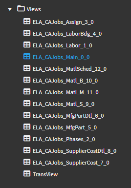

This is a list of views
There does not seem to be any view options that I can see.

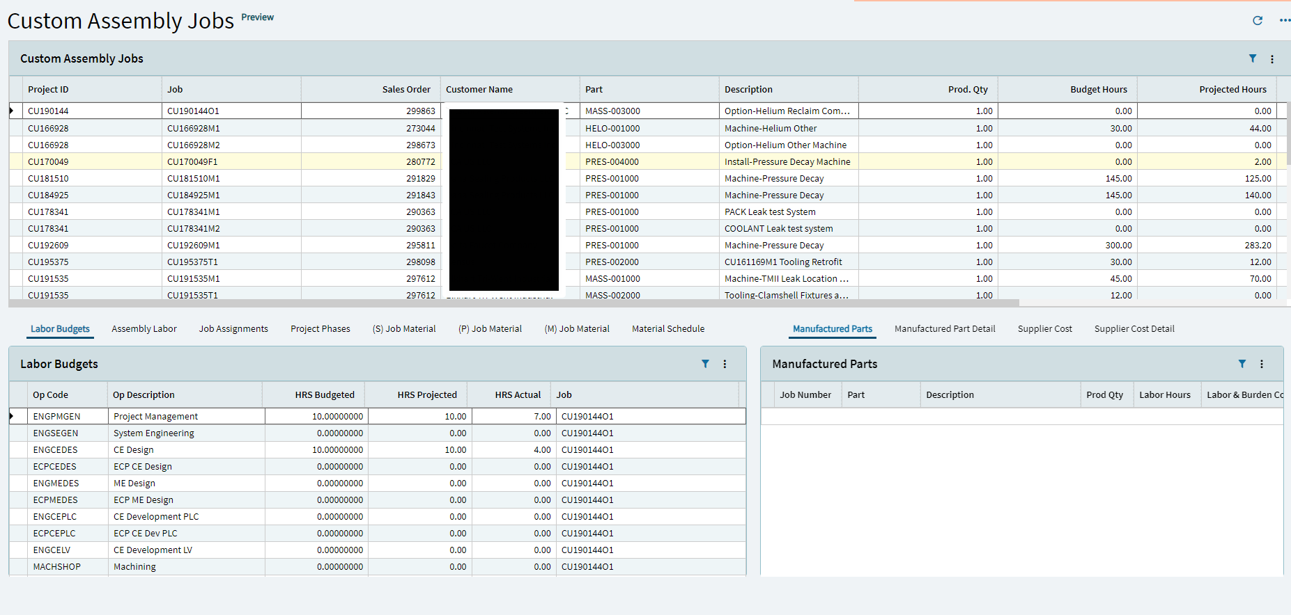

This is what the dashboard looks like. As you can see, there are several grids, not all are visible at once.
