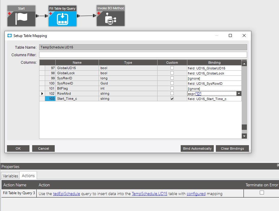

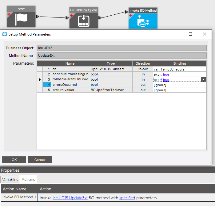

I’m working in an updateable BAQ using a BPM. My goal is to clear the UD15 table of its current data and then refill it with the new information that I would like to use. Currently, I am simply trying to clear the table out. My goal at the end of this is to have a completely empty UD15. I am using the query to fill the table and setting all rowMod to “D”. I’m then using the BO to UpdateExt on UD15. Is there something wrong with this setup or is there an easier way to do it? Any help would be greatly appreciated.

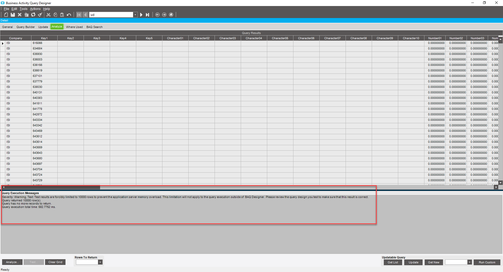

The first set of code appeared to work until I checked the UD15 with a separate BAQ which showed the old information still in it. Also if ran in a dashboard, it showed the old data. If ran in a BAQ, I received the same results as yours, until I checked it with the other or used it in the dashboard.

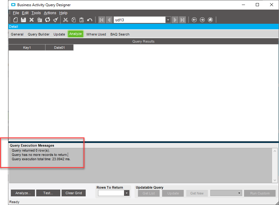

I moved it to the Base and same results. I am getting a record not found popup then the query response of 0 found.
My mistake–the second query I pulled up to validate was one that was already in the system. Turns out it had a criteria to filter records that weren’t entered today. Whoops.
