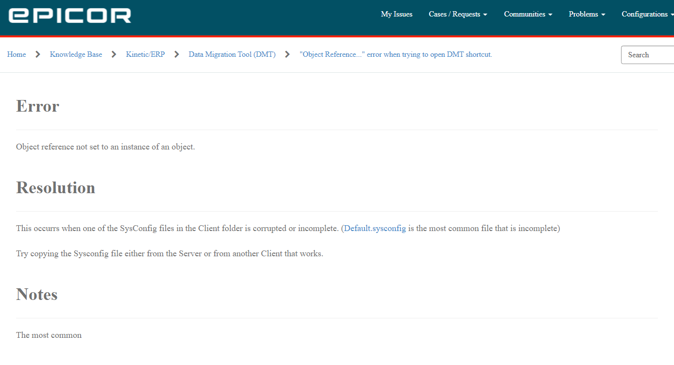

The issue is on the Default.sysconfig file.
I had to compare the PILOT and LIVE files and modify the LIVE file to match PILOT.
I used notepad++ and did a compare function between the two files to find the differences.
Basically you would be taking the PILOT Default.sysconfig file and substituting the PILOT URL with the LIVE one.
For reference, I found this solution on the Epiccare Knowledge base articles. I found that they’ve been more helpful for me recently. Especially with error messages.
https://epiccare.epicor.com/epiccare?id=epiccare_kb_article&sys_id=81e7a92adbae8c1404d52f75ca961937

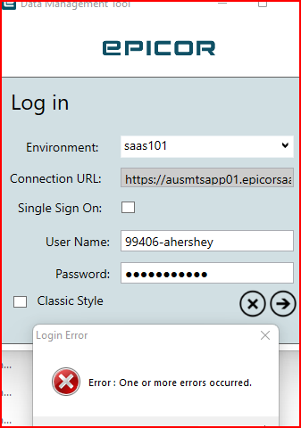

I have reinstalled the client and have copied the sysconfig file from pilot however I still get this same error. Anyone have a solution?
Adam,
The DMT error would have been “Object Reference is not set to an instance of an Object”.
The popup you have in the screen shot, we are also getting and not sure why. Just press OK and continue. Because you have the DMT login in the screen shot, you are making it past the object reference error.

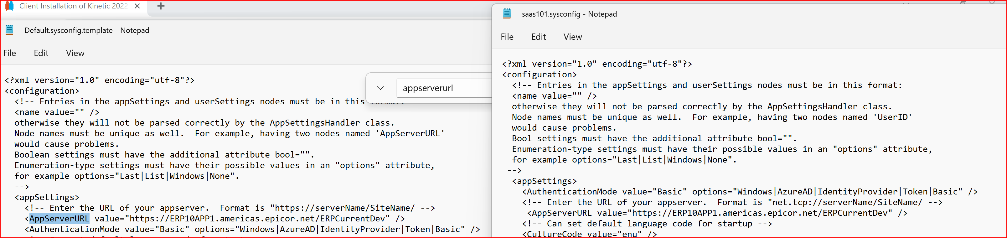

If you cannot continue, look in the config directory where all the client exe and dlls are stored. See if you have a default.sysconfig.template file - grab the line that starts with <AppServerURL value="https:// . Copy it to your default.sysconfig file and see if that doesn’t fix your error.
I copied the line but still get the same error.
