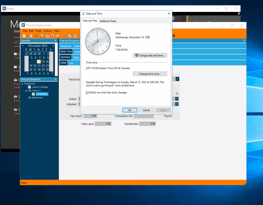

Yeah it’s super hard I had to modify the server time to be able to reliably test it
I created Jira bug ERPS-213225, now it is up to the Product Owner for review and prioritization.

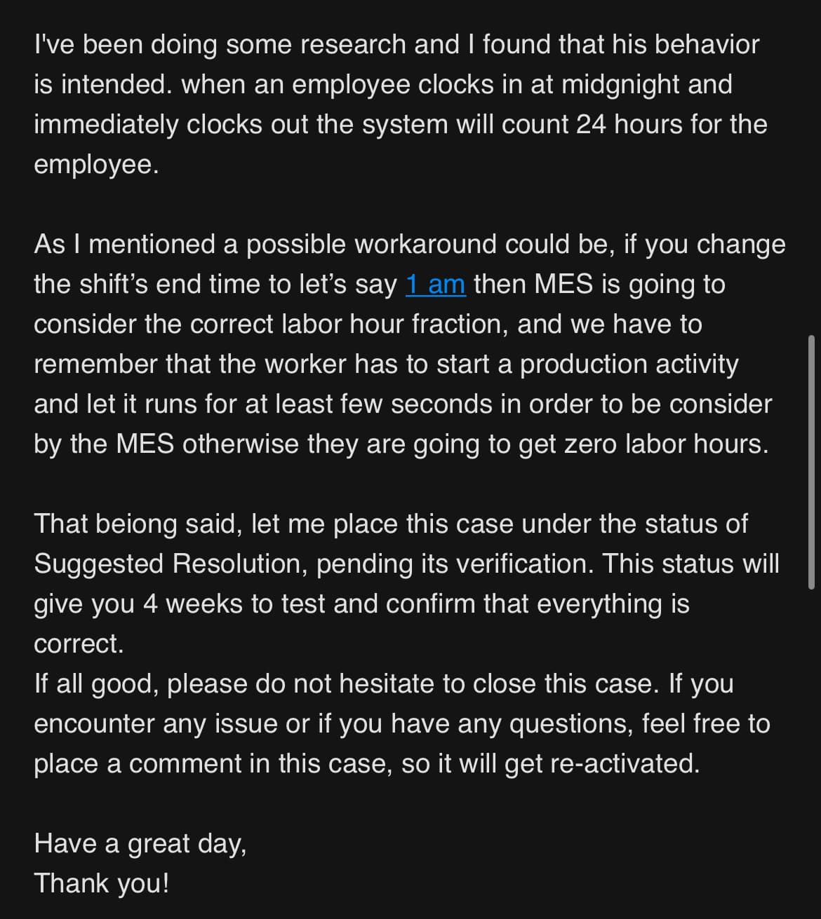

Support says it’s intended behavior to give you checks notes 24 hours for 59 seconds of work… that makes sense … :face_with_symbols_over_mouth:
I rejected their suggested solution cause it’s … well how do I put this politely…. ITS FREAKING STUPID
This is why we get so angry…. Like just accept the damn bug and add it to the backlog don’t give me BS cause you don’t want to deal with it :rage:

@gpayne Here is a replication of it happening, I can make it happen every time under these conditions.
TimeIssue
