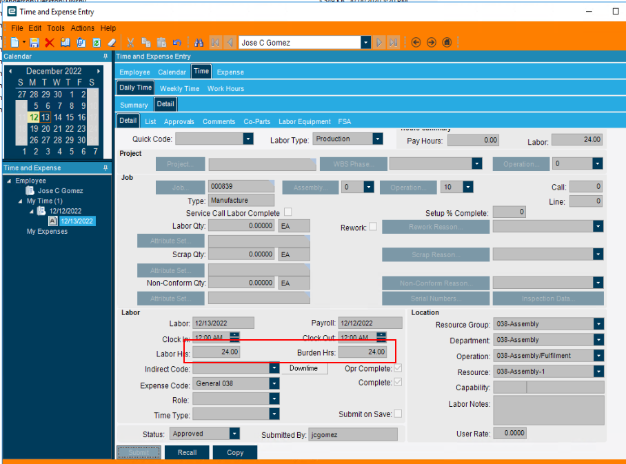

We run 20ish hours a day in some of our plants which means our second shift often goes past midnight. We have found that if someone clocks in / out of a job at exactly Midnight 00:00 Epicor will automatically assign them 24 hours of Labor (and Burden if setup). We have tried every BPM in the history of BPMs to get around this to no avail.

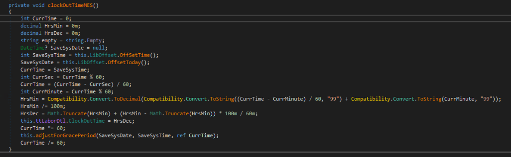

There is a little internal method that re-calculates ClockOutTime automatically inside the BO and even if you mess with it via a BPM it gets over-ridden in this internal function

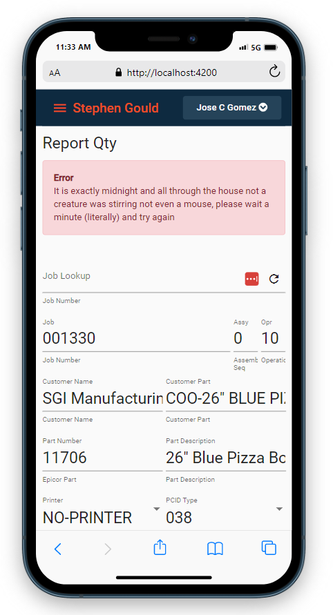

At the moment we have no work around, the one thing I did eventually do is check if the transaction is going to happen exactly at midnight I now force the employees to sit on their hands for a minute
This is a weird issue that mostly probably applies to us because we report labor quite frequently often seconds apart from one to another. But it is extremely annoying since we have COS/WIP running automatically which cements the problem and throws our costs into disarray.
Not looking for solutions just whining about the absurd logic at play here. It is specifically accounted for in the code that if ClockoutTime =0 then it tries to subtract from 24 hours

Epicor is not very good at maths… I still don’t understand why they don’t just capture ClockIn Time Stamp, Clockout TimeStamp and then do a Diff… This whole ClockInMinute since the year of the plague (10/30/1953… because arbitrary) thing is weird and needs a re-write.

:roll_eyes: ← we tried this problem is there’s a bunch of “other math” that goes sideways if we just change the 24 to a 0. So I :poop: on your suggestion :joy::joy:

Hence the festive error message he put in place to block them from clocking in/out at midnight. :sweat_smile:

Yea I stop it that’s what I ended up doing but it’s a work around and makes my employees have to stop

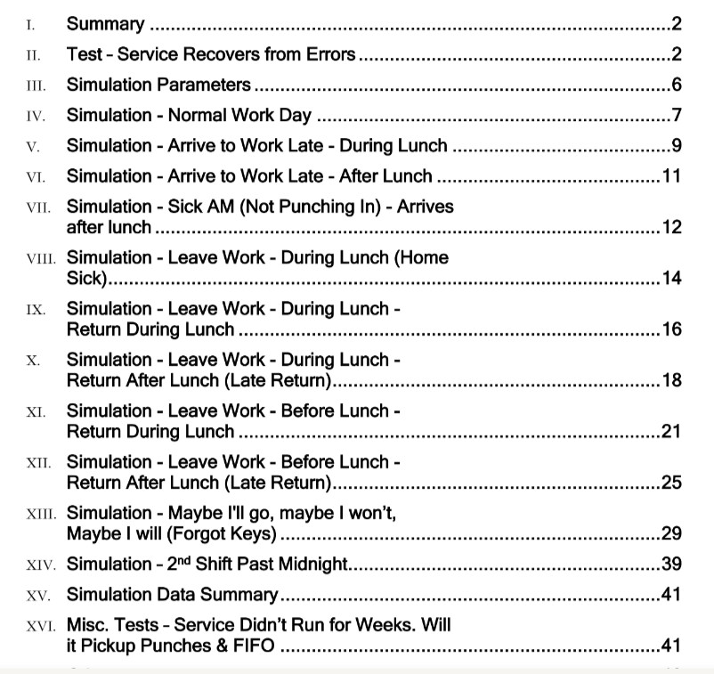

Internal note from 2017 I have in my inbox
