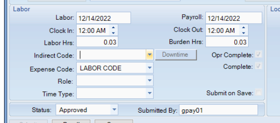

@josecgomez Have you tried “legally” adjusting the start back by at least a minute+ ? I have to slide things around on start and end because my timekeeping system I export to requires a separate minute for each export and I have operators that can do 30+ in a minute and I really only care about the quantity when things are that tight.
We do three shifts 6 days a week and in 12 years I have not seen this oddity, but I also do not have commissions riding on it. ![]()
Yes I can after the fact go adjust the time manually or via dmt
But at some of these jobs have 30 people working on the line it is tedious at best
We have recall the record change it and re approve it
And do it beofre cos wip runs which is scheduled overnight
As I was drinking and programming anyway I did a test. This may vary in your environment, but I moved start back 15 minutes in end activity at midnight and got .03 hours. 15 minutes ish

@josecgomez I did it in End Activity and it got me labor hours. I did not think to try resetting clockintime or dspclockintime. But if I look at the data clockinminute and clockoutminute are the same so it did revert at some point.
ttLaborDtlRow.ClockInMInute = ttLaborDtlRow.ClockInMInute - 15;
