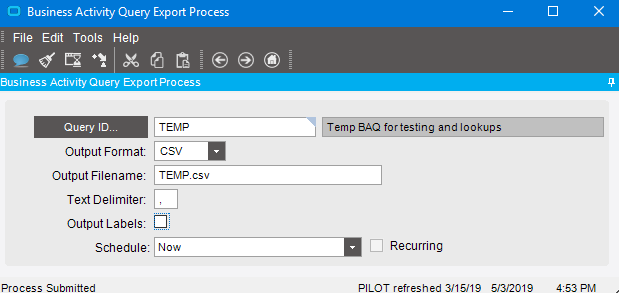

I tried with and without “Output Labels” - Checking it adds the BAQ Labels as the first row. If it’s unchecked, the first row in the csv file is the data. Is there a different place to select column headers instead of the BAQ headers?

If you run it as a BAQ export from the command line DMT tool, there is a command line switch to output field labels instead of BAQ labels.
