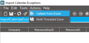

Sometimes the DMT entry doesn’t exists for your need. For example, I wanted to import Calendar Exceptions in bulk but could not find an entry in DMT. So I build a dashboard and, in version 10, there’s an option to import directly from Excel:
Works great
This looks great. Thank You very much. Could you please tell me how to get to it.

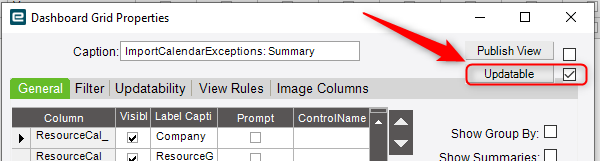

You just have to create an Updatable BAQ and make sure to allow new records.
Insert that BAQ in a dashboard and make it updatable.
Once deployed, the “Uptake from Excel” feature will be available in the Action menu. You also have the possibility to Paste/Insert form Excel.
