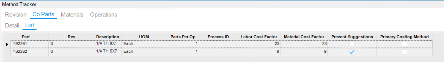

For our use case, the parts share the same sheet of material.
YS2261 = Part A
YS2262 = Part B
We can make YS2262 separately but for every sheet we put up for this operation we get 23 YS2261s and 9 YS2262s. These are setup as concurrent co-parts because we make both at the same time within the same cycle of the program. Noting that the method of manufacturing details are setup for 1 YS2261 and that we use standard cost.
