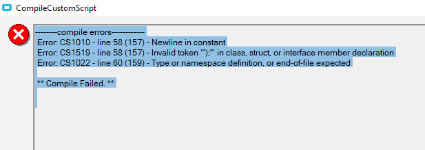

I’m trying to make a custom refresh button, but the code will not compile.
What am I doing wrong? (I did have the Control type set as Epi Button when I tried.)
I have tried putting these under the “Place Event Code Here” separately:
oTrans.Refresh();
and
SendKeys.Send("{F5}"); (F5 is set up as a refresh hotkey)

I mean it kinda tells you what the error is right there can you paste your entire code?

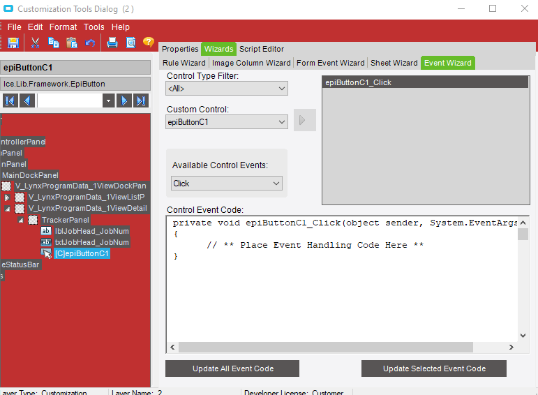

Sorry, this is my first time touching code in Epicor.
I’m pretty lost.
This is the Control Event Code, the only thing I am touching before it starts to give errors. :
private void epiButtonC1_Click(object sender, System.EventArgs args)
oTrans.Refresh();
josecgomez
(Jose C Gomez)
December 4, 2019, 8:51pm
6
You must be touching something else that error you are getting isn’t refering to this line, can you paste all your code (the entire script editor)
Also do you know/understand C#?

josecgomez
(Jose C Gomez)
December 4, 2019, 8:57pm
8
So you have a ton of extra } " ) at the end of your method not really sure how that happened… But that’s your issue. (if you look at your post I’ve formatted it for you, and you can clearly see the issue at the bottom there with the orange parenthesis and curly braces.
