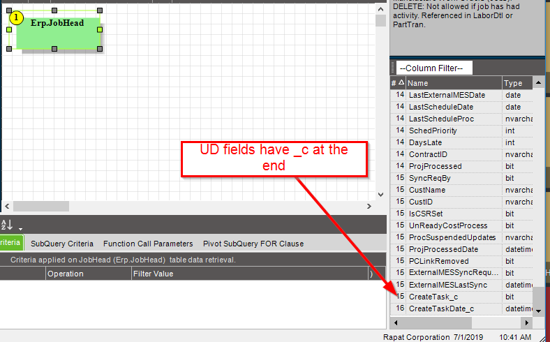

Did you look up the column in a BAQ and see what the actual column header is? I believe an added UD field always has _c attached to the end of it.
I thought that the added fields always ended with “_c” too. But that is incorrect. If the field existed as a UD Filed in E9 (like Number01), it will come in with the same name (i.e. no “_c” suffix).
right, but the poster said he added the field after the upgrade to try to get it to work. Either way, he should look at it and see what the actual column header is.

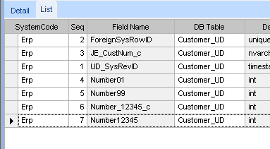

For what it’s worth …
The “_c” suffix won’t be added to fields that “look like” old UD fields. For example, I can add “Number12345” and it takes that name. But “Number_12345” becomes “Number_12345_c”
