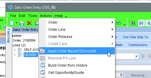

After selecting Apply Order Based Discount from the Actions menu

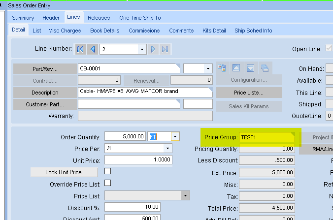

Does anything show in the Pricing Group on the Line -> Detail sheet?
I did a test where I have a Pricing Group that has two Product Groups assigned, and a Value Break of 10% for $10,000
Creating an order with two line (one of ecah of the two PrdGrp’s in the price group), each for under $10,000, but combine to over $10,000, I get a discount applied to each
Apply order based discounts was the problem. Anyway, took a while but I found a few tings in the Help File I’ve been reading. Its not worded the way I would of thought it would be. and that is probably because it was designed by people much smarter than me! :grinning::rofl::joy:
Yeah… The biggest catch is that the discount will be calculated even if the Order total drops below the Value criteria, UNLESS you re-run the Apply Order Based Discounts…
So if you enter a line for 10 of something that cost $1,000 each, and apply a discount (of 10% for orders >= $10,000), it will put a $1,000 discount in.
If you then change the qty to 9 (for a pr-discount total of $9,000), it will still apply the 10%, and give you a $900 discount.
You should re-run the “Apply Order Based Discounts” prior to printing.
