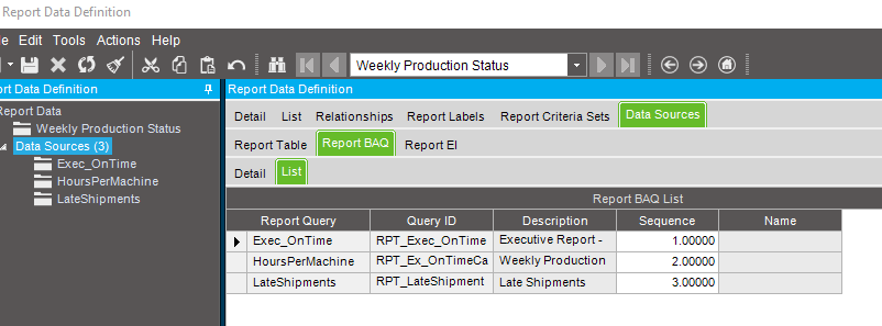

You can create a report from scratch and make your own RDD containing 2 separate BAQs. They will show up as two separate datasources and able to be referenced on the report. You can either use them independently or you can combine them using a query on the report. Don’t do a BAQ Report. That is limiting you to just one BAQ.
I’d be open to that as well…do you have some insight on how to get started with that?

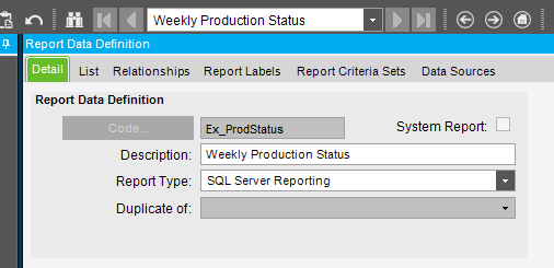

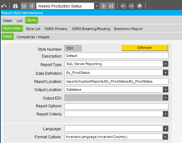

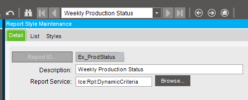

Open Report Style, and create a New Report. Use the Report Service shown.
By default, the RDD is created using the same name as the report. Open that guy up.
Create a new data source for each BAQ.
If you’re combining the BAQs in the report into one table, you may want to create a relationship between the data sources. If they will be separate, then you don’t need to do that. I didn’t on this one.

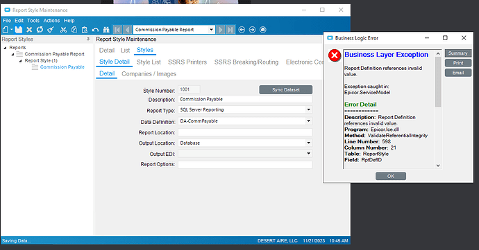

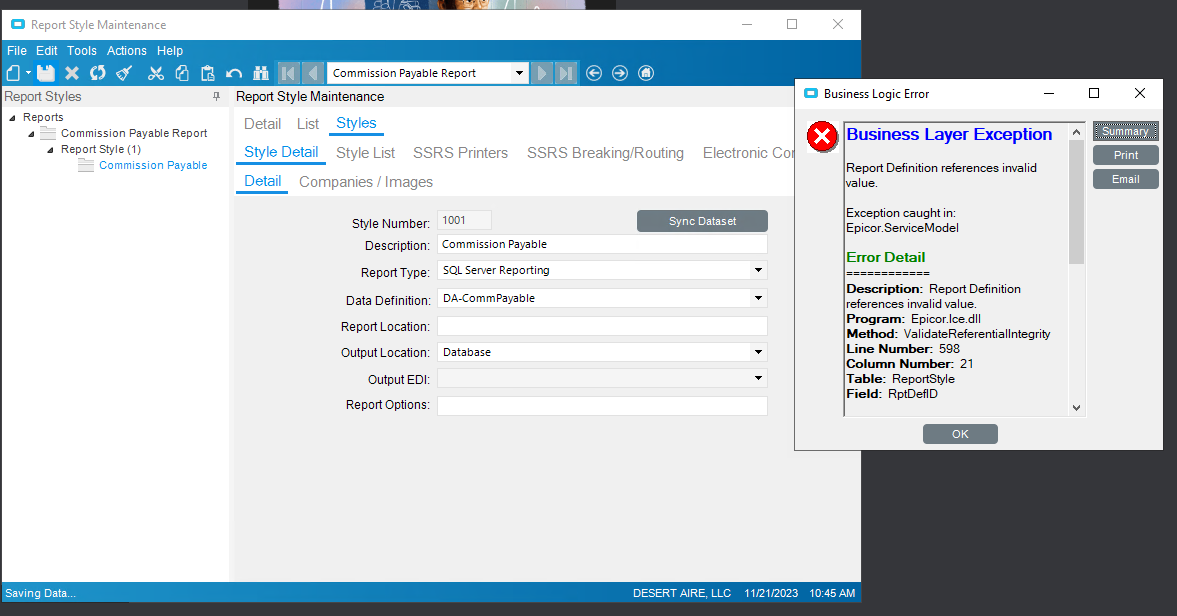

I am getting an error while trying to create my report style. I’m not sure if it is the report location, but even when entering something similar to the one you showed…it still gave me the error.
Is the RDD setup and configured for the BAQs? The name matches? That error seems to indicate that there’s something wrong in the RDD.
You’re right…I thought it was gonna auto create the definition but it didn’t so after some fiddling around I got it to work and I have my SSRS report…now I just gotta figure out how to put the data the way I want it

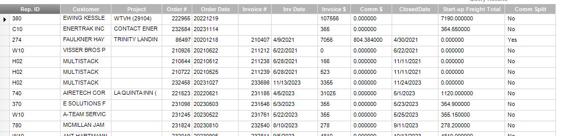

So essentially what I’ve done is grabbed the necessary data from both tables. It lists all part numbers under an order…and lists an invoice if one is available. It also shows the order total and commission split for each part number. Now I just got to figure out how to group the part numbers together into orders, while keeping orders with multiple invoices, and keeping an order with line items that don’t have an invoice separate. And summing the invoice/order total, and commission total.
